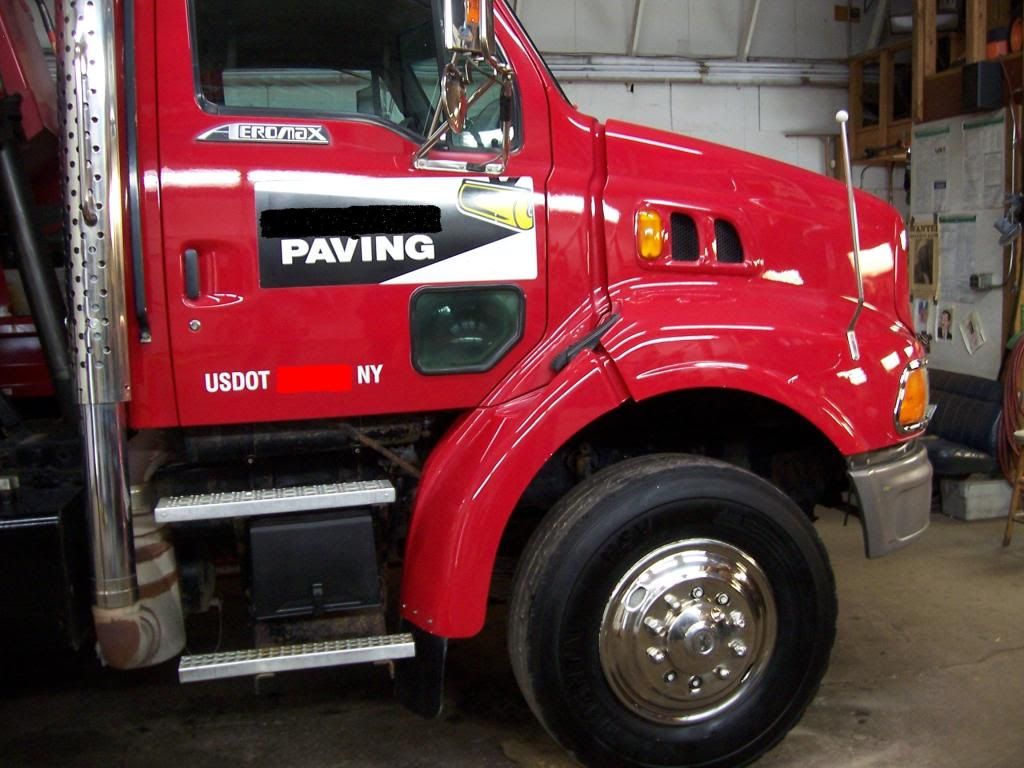

Another detail site I am on, Tom did paint correction on a 14 year old red Ford Lorry ( just the cab, the dump body hauls paving material, so it gets washed with fuel ( straight gas ) to remove the paving material from it.

Thanks man. :) Awesome looking job on the truck! Cleaning with petrol?! Sounds pretty crazy, I think I'll give that one a miss, besides with fuel the price it is over here it'd probably be the most expensive detailing product around!
